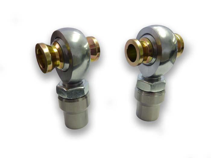

160 баксов? Єто за позолоченый ШС или какойто редкоземельный? Вот обойдется такой комплект дето в 85-90 :
Product Description
3/4" Rod End Sets (Heim Joint, Rose Joint)
4140 Chromoly and Alloy Steel
Chrome Plated Ball
Nylon Race
Ultimate Radial Static Load (lbs) 27,019
Each Set Includes:
-1 Left 3/4" Heim with a 3/4" through bore.
-1 Right 3/4" Heim with a 3/4" through bore.
-4 Zink Plated Missalignment spacers with 34 degrees of misalignment, Reduces to 5/8" Bolt hole
-Left and a right hand zink plated Jam Nut
2- Weld in Tube Adapters to go with them (For 1" tube ID).
Есть и на 7/8", чуть дороже.

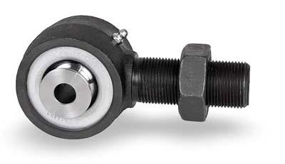

А еще есть такое Creeper Joint дето по 55-60, они сразу с пресмасленкой идут.
